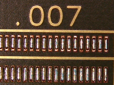

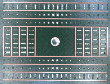

Stencil Aperture Change Due to Board Finish?
Is there any reason to alter apertures on stencils if board finishes change from ENIG to OSP?

This will depend on your solder paste and inspection criteria. Some solder pastes do not wet out to the corners of pads when used with OSP finishes. If your inspection criteria require full pad coverage then you may have to go to full pad or near full pad printing. This can cause mid-chip solderballing issues if overdone.

Stencil apertures should not be affected by the change from ENIG to OSP. Aperture dimensions are related to the size and volume of paste applied rather than the board coating.

Typically there is no change in stencil apertures when changing from ENIG to OSP PCB surface finish Flux activity and paste transfer volume efficiency (function of flux chemistry that determines how much paste gets transferred from the stencil to the board as opposed to getting trapped in the stencil) are crucial in wetting and spreading on OSP pads
  • good flux activity means better spread
  • high paste transfer efficiency means more paste and more flux especially for small apertures
This becomes even more important with Pb-free pastes. Nitrogen reflow could improve spread but the cost adder is so high that normally the right solder paste is selected for optimum results in air reflow With OSP and Pb-free no-clean pastes where there is normally a stencil aperture reduction, solder spread is not complete - this is normal See photos of Indium 5.8ls Pb-free no-clean solder paste reflowed in air on OSP finishes https://www.circuitnet.com/experts/uploads/1/5.8LS_Air_3_380.gif
https://www.circuitnet.com/experts/uploads/1/5.8LS_Air_1_380.gif
