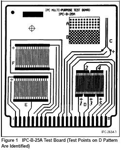

I have a question about moisture and insulation resistance test.
Why do some test methods (IPC-TM-650) identify the use of a IPC-B-24 coupon, while other methods require using a IPC-B-25A coupon?
What is the difference between a B24 and B25A coupon?

The B-24 is a single sided coupon with only 4 comb patterns 20 mil spaced (16 mil) line, while the B25A has 2 of the B-24 comb and one Y pattern and one 12 mil line and space (Pattern B from the original B25 test coupon). I have attached a comparison of the different test coupons used at Foresite called Comparison of Test Vehicles.

Thanks for your question. The answer is derived from Appendix C of IPC-9201 Surface Insulation Resistance Handbook. This Appendix discusses SIR test vehicles specifically, but these test coupons are also used for other kinds of tests. You'll see that the B-25A has more test patterns than the B-24.
The use and configuration of IPC standard test boards are the province of the various IPC task groups. As an example, the IPC-B-24 is controlled by the 5-24a Flux Specification Task Group. The IPC-B-25A is the province of the 5-33b Solder Mask Task Group.

The IPC-B-25A board was designed by the IPC Solder Mask Performance Task Group as part of the IPC-SM-840 Revision C effort. Prior to the C revision, the qualification vehicle was the IPC-B-25 standard test board, outlined earlier. The B-25 board was fairly large and expensive, and only a small portion was used for SIR testing with solder masks. The B-25 board had no guard banding for SIR testing and several flaws in the test board had been identified.
For the IPC-B-25A test board, two comb patterns from the IPC-B-24 test board were included and are designated patterns E and F. Pattern D was included from the older IPC-B-25 board, identical to pattern B/E. This pattern was included such that Bellcore (Telcordia) could use this test vehicle for materials qualification to NWT-TR-000078 or GR-78-CORE. Pattern C, the military Y pattern, was used to link to extensive qualification databases in the military.

If you are testing liquid or paste flux residues, you will need to use the IPC-B-24 test coupon.
B-24 is a Surface Insulation Resistance test board, and the IPC test method for this board is IPC-TM-2.6.6.3
B-25a is a multi-purpose test board used to evaluate the affects of moisture and insulation resistance of solder masks.
The IPC test method for the B-25 coupon is 2.6.3.1

Test method 2.6.3.4 (Supersedes 2.6.3.4 and 2.6.3.1C for Conformal Coating Test) Moisture and Insulation Resistance – Conformal Coating
IPC-B-25A, Test Coupon
1 Scope This test method is used to determine the moisture and insulation resistance of applied conformal coating under prescribed conditions of temperature and humidity. Raw material qualification testing is performed on designated comb patterns.
