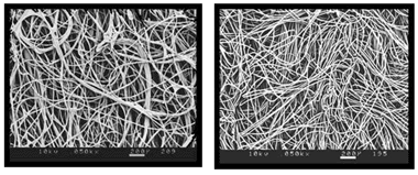

  3. Upgrade Your Current Process: If you don’t want to use presaturated wipes, at least switch to a high-purity, electronics grade stencil wiping paper with high absorbancy and high strength. The use of good paper will, by itself, make a big difference in the quality of the cleaning. Again, my company also provides products for this application, for example the 15cm x 15cm “MicroWipe FP” package that’s very affordable, very clean and leaves the minimum residues on the board. The photos below show some of the differences between cheaper paper and high-quality paper:
The paper on the left is made from polyester fibers and glue. It is a sample from a very common stencil wiping paper. The fibers are short and fragile, easily breaking in use. Notice how the glue fills up the spaces between the fibers, and coats the fibers with a solvent-soluble residue. All of this is undesirable.
On the right is a sample of a high-purity stencil wiping paper. The fibers are long, strong and (although you can’t see it on the phone) uncompressible, so they scrub rather than break away into lint. Paper made with these fibers will scrub the bare board or the stencil and leave almost no residues behind. This gives you a much cleaner board, a cleaner stencil, better printing, higher yields and more profit at the end of the day.
