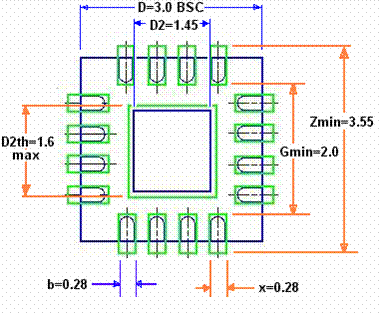

The package is a 44 pin LPCC/QFN, it has a heat-sink pad on the bottom.
The stencil arpeturet is reduced 40% on the heat-sink pad.
The part is not self-centering it is moving out of alignment.

“There are two basic designs for PCB land pads for the MLP: Copper Defined style (also known as Non Solder Mask Defined (NSMD)) and the Solder Mask Defined style (SMD). The industry has had some debate of the merits of both styles of land pads, and although we recommend the Copper Defined style land pad (NSMD), both styles are acceptable for use with the MLP package.
NSMD pads are recommended over SMD pads due to the tighter tolerance on copper etching than solder masking. NSDM by definition also provides a larger copper pad area and allows the solder to anchor to the edges of the copper pads thus providing improved solder joint reliability.
The thermal pad (D2th) should be greater than D2 of the MLP whenever possible, however adequate clearance (Cpl > 0.15mm) must be met to prevent solder bridging. If this clearance cannot be met, then D2th should be reduced in area. The formula would be: D2TH >D2 only if D2TH < Gmin - (2 x Cpl)
Figure 3-4 is an example of a PCB Land Pattern for a 3x3-16L with an Exposed pad (D2) of 1.45mm.

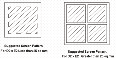

It is good practice to minimize the presence of voids within the exposed pad inter-connection. Total elimination is difficult but the design of the exposed pad stencil is key.
Figure 4-2 shows some suggested screen print patterns. For exposed die pad sizes less than 25 mm2, a single slotted square pattern is recommended. For larger areas, a matrix of squares will minimize voids and normalize the standoff height for the exposed pad and the terminals. (If large exposed pads are screened with excessive solder, the device may "float", thus causing a gap between the MLP terminal and the pcb land metalization. See Figure 4-3.) The proposed stencil designs enables out-gassing of the solder paste during reflow as well as regulating the finished solder thickness.

Suggest you look at IPC 7525 for aperture recommendations on the ground plane. Window pane aperture at about 50% area reduction. Also might look at 1.25 to 1.5 times aperture width for the 8 corner pads.

This is a pretty common problem with this type of component. The secret here would be to reduce the center aperature to 60%, but you want to do it in a “window pane” configuration. This will essentially create 4 large pads of solder in the center ground area, helping to maintain registration and alignment of the part during reflow.

Your suspicion is correct, the center heat sink pad is causing the movement. Printed solder paste tends raise parts in the z-axis during the initial phases of reflow and as it coalesces. This causing the QFN's to rock slightly and shift resulting in miss alignment. We generally recommend a 50% reduction and window pane design to reduce this movement.
